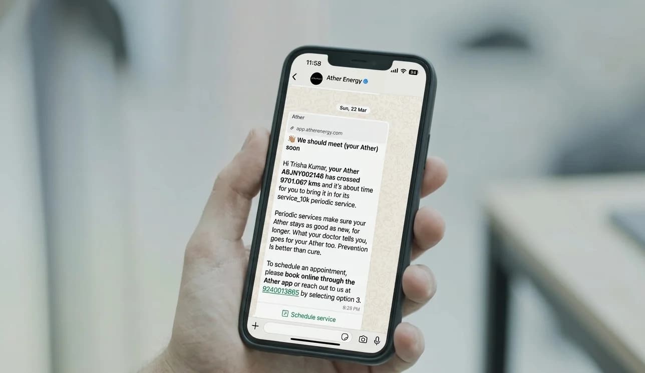

What is the Recommended Service Schedule for an Ather?
The recommended service schedule for your vehicle involves comprehensive inspections (38 points + washing) at a service near you every 5,000 km or 6 months.

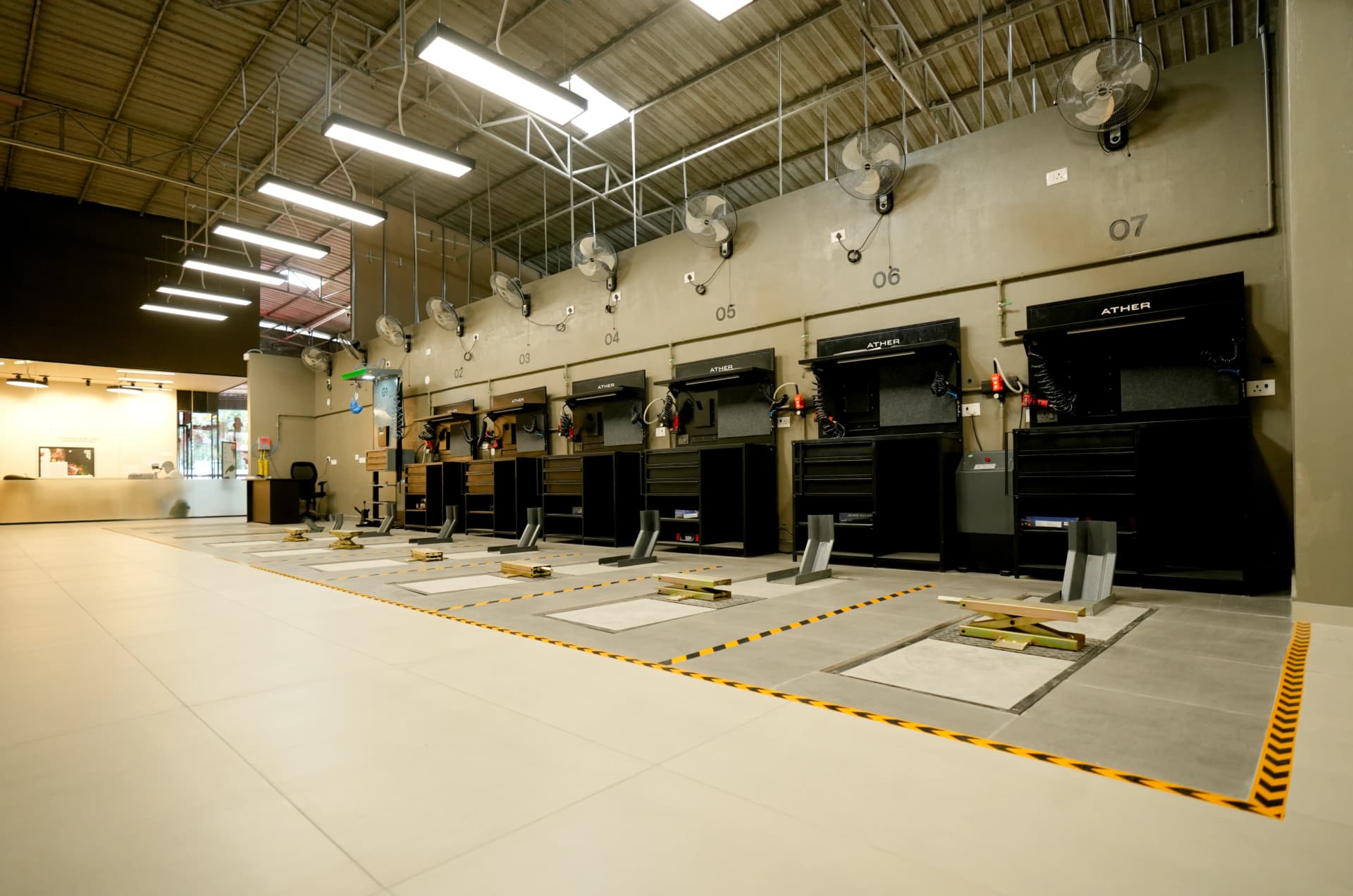

Where can I find an Ather Service Center Near Me?
Finding an electric service centre is highly convenient because Ather operates a massive network of 584+ active service centers located across key cities nationwide.
  • Whether you are located in Tier 1 metros, or Tier 2 or Tier 3 cities, we have a significant count of workshops equipped with highly skilled technicians & spares ready to assist you.
  • To find the exact address of your nearest Ather service center, simply visit the [Contact Us Page] and enter your location.
