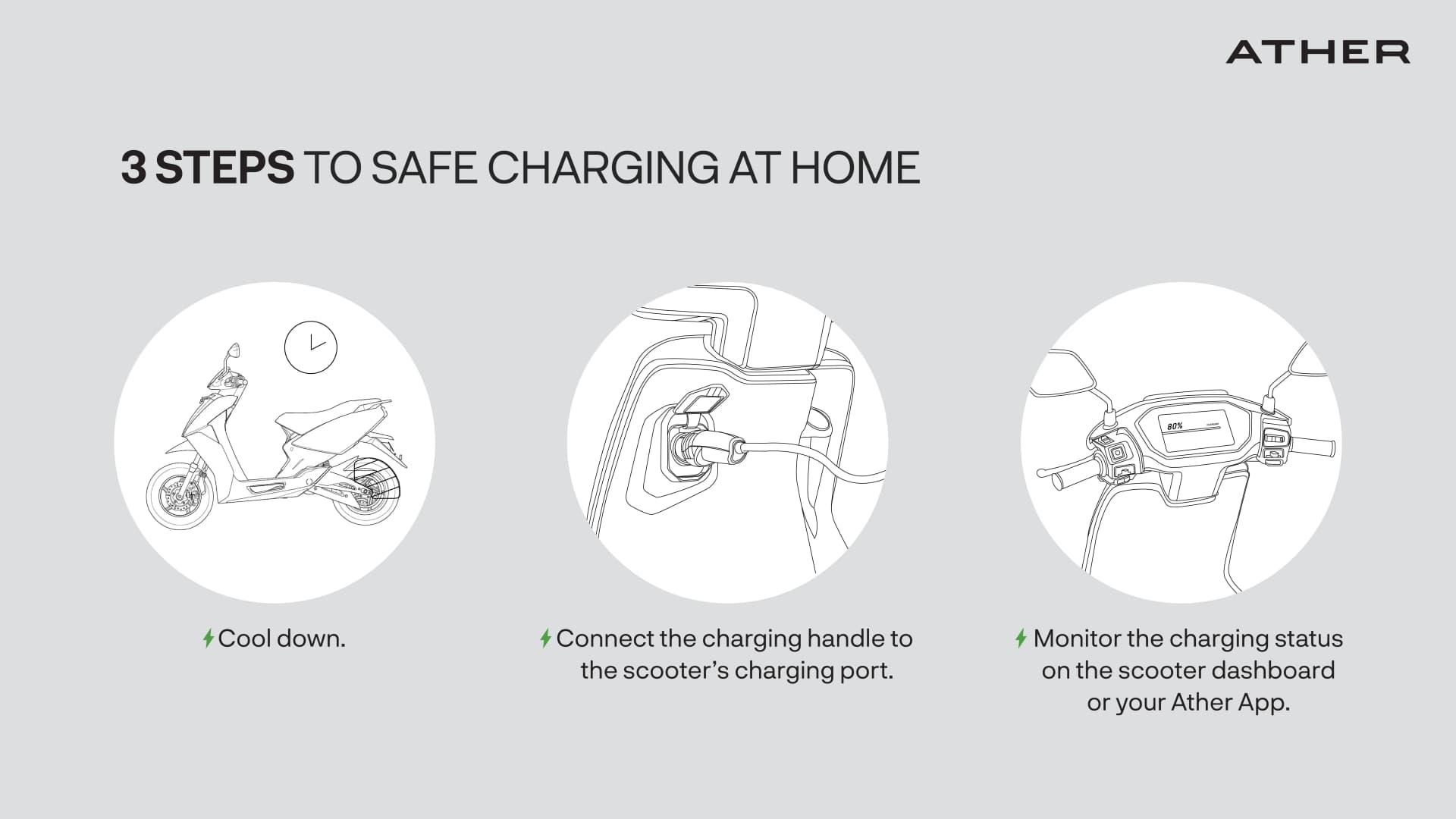

      Charging your Ather is as easy as charging your phone. Follow these three simple steps:
      • Setup: Refer to your owner’s manual to ensure your charging point is installed in a cool, well-ventilated spot.
      • Connect: Turn off the scooter. Plug the charger into the wall first, then firmly click the charging handle into the scooter’s port.
      • And Relax: The intelligent system automatically cuts off power once the battery is full, so you can just plug it in and forget it.
